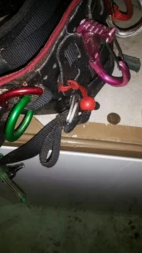

One gripe, is the bridge riser adjustment slips all the time on mine, pisses me off to no end.

Evo if you mean the hip to lower D adjustment slipping. Find the sweet spot and sew a webbing stopper. It will never move again. That is the first thing I do. I cut the webbing and sew the loop in sweet spot. But I have access to a commercial sewing machine. A webbing stopper will work just as good. My saddle always gets all excess webbing cut off. And new loops sewn. I like you love loose leg loops.
