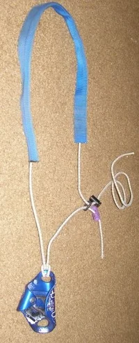

Re:Chest ascender tether Version II
Chris gave me an idea for changing the adjuster. Thanks!
I have no clue what the breaking strength is for the elastic cord. When I pull on it by hand it really stretches. There is a valid concern about the possibility of having any cord around the neck becoming a choking hazard.
To address the choking issue I added two toggles and a keeper. The ends of the elastic is not knotted so the cord should slip if anything were to ever snag the tether.
This passed the Low and Slow test. Flight time is on Saturday.
