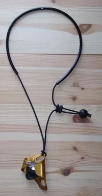

My version of the neck bungee is attached. Works well for me across a range of harnesses e.g. the Petzl Navaho selection, Petzl Sequoia SRT, plus the obvious.
Using either a half round Maillon Rapide or a karabiner in the lower hole allows a Croll (chest ascender) to adapt to pretty much any harness.

Thanks for sharing the picture. that is very clever!
Having the adjuster up and over to the side is a nice detail. Version II will look more like yours.

There's something about having a cord around my neck that triggers a concern.
I would opt for a loop runner across the back that the arms can slip through.

What is your concern? Choking? I guess it could happen. the elastic isn't that strong and if it did snag I bet that it would slip out of the cord lock. speaking of the cordlock, to address this issue I'm going to remove the stopper knot in mine so that the cord could slip out. thanks for helping me make it just a bit better. A work in progress!
I doubt that either would ever happen Kevin. The elastic has so much stretch that it would probably slip over my head before it gekked me.
How could my neck be snapped in a fall from the tether?
In a short fall if a stub or branch got caught in the loop and that key ring broke the cord now becomes a noose.
The cord might break or pull through before that happens but if it gets bunched up at the adjuster and can't get through the hole something else might give.
It's a long shot but the potential is there.

This is going to go into my 'windshield engineering' file to ponder while I'm driving. Right now I'm convinced that some part of the system would break a long time before there would be a risk of getting choked.

That's not the first time I've heard concern over choking risk when talking about neck bungees.
You are correct, the risk is there. But overall, I'm not sure that the more commonly used alternatives are better....

The bungee could easily be a choking threat, by a branch pulling up the cord from over the shoulder, because of the stretch. I doubt this would be a real danger though, as the cord should snap - depends how strong it is.

The Croll on a bungee isn't very efficient - allows slack and doesn't offer support
The bottom of the Croll is still rigidly (non-stretchily) attached to the harness. Only the top of the Croll has the elastic - to compensate for the changing length between the shoulders and waist (front). When I've used a homemade version of a Petzl Secur, the Croll is slacking up on every cycle when I draw my legs up (and my torso curls) and the harness "stretches" away from my pelvis. An elastic link in the system would be great! If I tighten up the Secur enough to eliminate the slack, I can't get my body upright!

After trying several flat webbing configurations and finding them uncomfortable I decided to go with the elastic.
I've found that with my setup the ascender stays up and fair more of the time than with the flat webbing rigs. It's a simple tug on the toggle to tighten and squeeze to loosen so I can go from one to the other smoothly.
The way that Chris has his set up is clever. Yesterday I thought of a little mod to that. Now I have to find my smaller diameter shock cord.
