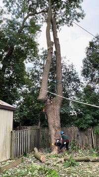

Crazy leaning 90' pine today, hanging towards buildings. Using a combo of a rope puller, high block in a neighboring fir as a swing-line, and a sizwheel on the stump we were able to get it like 75* away from its heavy lean. Lots of pre-tension, bore-cut, cut the trigger and let the swing-line go at just the right time. Ignore the stuck throwball in the tree, haha.

I wouldn't like to be under that load!
I don’t think that stick is coming in over 2k. A properly rigged static pick in a propery spec’d rig gives me little pause. I substantially smaller piece being negative righed (rigged to disadvantage) can introduce peak forces greater than the loft in that photo.
I can go as far as saying that before the crane came into my quiver, that sort of thing was pretty SOP. I prolly would have doubled whipped that one with a block on the pick and terminated near the top block.
I'm Not calling a foul. :)
A redirection to a remote trunk for the GRCS would make me feel better.
A power drill and consistently watching upward would be another mitigation. I'm pretty quick, still.
Heard that. It’s what prompted my previous comment about the drill and adapter. That tool is a game changer.
