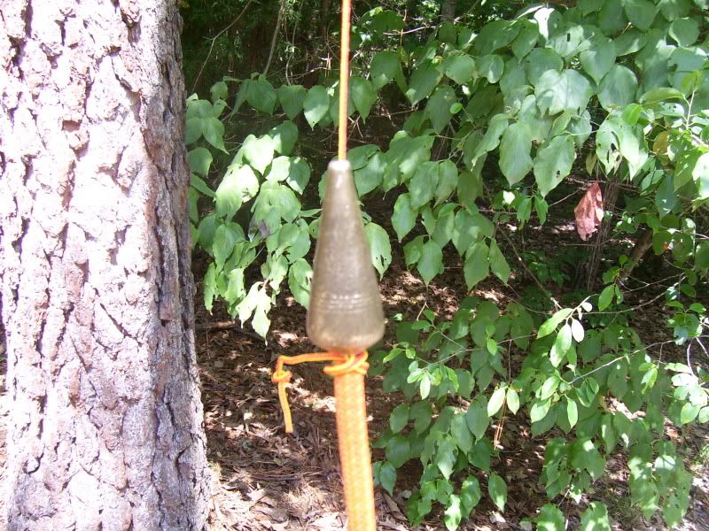

Say Caleb, I modified a brass plumb bob as a throw weight. Drilled a small hole straight through for the throw line and a large hole for the end of the rope. You can't see it very well in the pic, but the pointy end is rounded over and sanded smooth. I use a stopper knot on the end of the throw line and then pull it through and tie a pile hitch as you showed me near the end of the climbing line, then pull the rope inside the bob as shown to hoist. It ends up weighing 13 oz.
Surveyor I see you like my choice of throwline ( target ), works wonderfully down here on my trees and I have tried them all. Hope you not planning on getting hit by that plumb bob, stay out the way. I know 13 ozs is 13 ozs however that is a dense particle situation as opposed to a throw bag. Is very aerodynamic though. Studied surveying in University so I know a bit about plumb bobs. However I like working in trees way better.
Yes you need to be careful with this weight. Also Adam,if you make one,be sure to tie an overhand knot about a foot down the throwline from where it enters the point, so you have a stopper on both sides of the weight. I have been trying to get it stuck, but so far it always pulls out. The 13 oz. seems about perfect for me, but you can obtain many different plumb bob weights.
Thanks for the tip, surveyor. I picked up a lot of 4 vintage brass pb's on ebay. It was 3 16oz and a 24. I figure after I drill them I can turn them a bit at my friends house to get them to the weight I want.

I was able to get the Plumb Bob stuck today, although I did not wear gloves to really bear down on the throw line, but rather, I tried to finesse it out. So I used my NZ throwbag, and removed the line from the bag after each failed throw. Finally hit a very small but good target, and ascended 40' to retrieve the Plumb Bob. I found the line wrapped twice around a small upright branch and then draped over the main branch.
