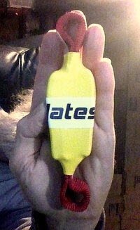

This gives you an idea the size of the Yates Shorty. Sorry for the crappy photo, using the web cam on this computer as I have one sitting right here. This is the one I fell on recently, so I ordered a new one.

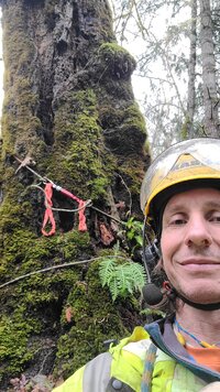

For those who don't fully trust a screamer as an in-line device, a set up like this with a couple of butterfly knots and some slack for the screamer to unfold would work. I think this is something like @southsoundtree has in mind.
You would have to use some linkage like quickies or carabiners to attach the screamer.
I had my rope through a Petzl Rig so I could be lowered down if need be. I just had the screamer between the Rig and the Tenex Tec ultra sling around the tree, but that puts it in-line as a life support. I trust the Yates screamers so it doesn't bother me being a life support item.

The screamer application seems pretty no brainer, but the first time I saw the "tall head" arborist helmets with basically zero side impact protection I said WTHeck take a drop (like Shadowscape's into the trunk) and your helmet is wanting regarding side impact. Coming from a motorcycle background. Enter the Protos - yay but what about all those other helmets? The other worry was bodily stub puncture.
Looks super compact. What is the deployed length, or the recommended amount of slack?
Looking at @Shadowscape ’s drawing has me disliking the loose loop of critical climbing line. It would be the cats ass for a slinky style sleeve to keep it all tucked into.
I think a few companies have 5:1’s that are in a fabric tube.

The Shorty I have is 22" deployed.
If nothing else, one could fold and tape up slack. A few turns of masking tape wouldn't interfere one bit.
Wonder how a simple daisy chain would work
Not really a lot to play with. Screamer 6" long new. 22" long used. Leaves only 14" of slack rope, 7" down and 7" back up. Not much to daisy chain when it is anchored at both ends.

I will just continue using mine in-line. The shorty is rated for 24 KN, which is about the same as the ropes I climb on. Heck, my carabiners are not rated that high and I don't worry about them. A pre-climb inspection and it is out of my mind.
Crusty veteran maple...a neighborhood favorite for sitting under. Needed some hazard mitigation. The side shown was all dead. The live half (or less) on the good side has small "goose pen".
I always have a handful of slings and biners handy. The slings serve no purpose here, just using the biners for the Screamer.
I removed about 1/2 of the wood that was up there...mostly completely dead, some smaller potion barely sprouting on broken trunks.
