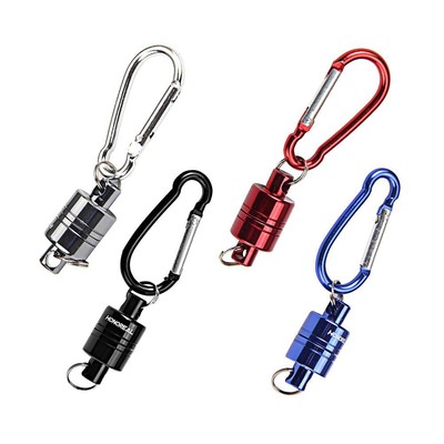

Anyone have a source for good magnets now that yoyo's currently occupied with other concerns?
I bought this, and it's made surprisingly well. Don't know about long term durability, but I think it would work well with a few minor upgrades.
