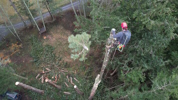

When I'm just smashing out firs, where there is no cleanup or a machine will clean up afterwards, I usually don't have a rope out at all, all 200' are in my backpack. That way I can bomb brush and logs all I want with no worries of messing up my system, can spin around any way I want without wrapping up the trunk, and still be able to bail to the ground at any point since I'm already tied in and just advance that along with my flip line. It is a good bit of 'extra' weight, but much of my work is solo and in deep woods, so I usually don't have ground help, it's just my normal way to do a lot of work.
I can relate as I also work alone most of the time and have buried my lines under branches and chunks. Makes for a bit of a pickle, especially if you are MRS and you can't free up your line to get down. Been there a few times. I am going to try your backpack method.

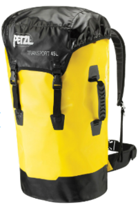

It takes the right kind of backpack, one big pouch with a top flap, the more simple the better. I have two of these North Face Cinder 28 packs which are made for mountain/rock climbers with a stiff durable material and good straps. I can rap to the ground and it just pays out of the bag as I go down, or more smoothly if I take it off my back and hold it below my waist.
Unfortunately they don't make them anymore, and I'm always looking for used ones to show up so I can buy extras...
Yah, that Cinder 28 fits 200' of line perfectly, and serves as the rope bag it lives in. It's actually my most used system, as that tends to be the most common work I do.
Digging around, the Thule AllTrail X 25L seems to be the closest thing to it I can find, but there are probably some others out there that are similar.
Oh, that one looks like it would do. Thanks. Going to give it a go with the 30L one I have first. If it seems to work out for me, I will upgrade to a better pack. I'm excited to give it a go. Tomorrow is all planned out!
