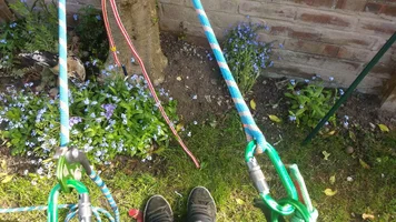

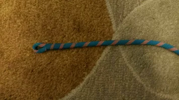

That is most definitely Da Kine! That's awesome Tommy B, you definitely have the drive and patience to do some awesome splicing! I always thought that kernmantle rope had to have sewn eyes, now I have to try it out, just because I've seen someone else do it! Great splice, my fellow splicer.
