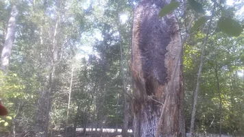

Three months ago this 39" dbh Quercus alba lost a co-dominant trunk near its base (see photo). The canopy of the remaining tree is luxuriantly full and green. There's lots of scarred over tissue (included bark?) in the wound, but there's also quite a bit of torn wood at the base. Is there anything helpful to be done to treat or clean up the wound?

I'm curious myself.
Anyone know about or used Trichoderma products on tree wounds?
Is it too late for this particular tree?
Carefully trim away the Shaggybark and tried to leave a smooth surface that will capture a minimum of debris. Then you have to look at reducing the remainder, to take the strain off this week area.

Thanks Guy for advice on this. I appreciate also the reason given for trimming away the shaggy stuff.
