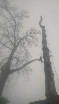

9EE8F8B2-D223-4E27-BFE6-565B945CDC66.webp The trichomes seem to collect in the loose bark as well as those golf ball size seed pods that they hold onto forever. I’mgoing into day three of a large tight quarters removal and the chipper filters are loaded up at the end of the day with less than a load of chips. I’m one of two that will mess with them in leaf where I work. We’re not immune or tougher than most. Just dumber I guess.

Damn Rich how big was that dude?
Still a big one. Plane most likely. I don’t really know the difference yet. The spar to the right is around 90’ from looking at my climb line. The one I’m in on the left tops out a little bit taller with a DBH OF 56”. Had a drip line around 75’ for my guess. Wide SOB with very little bucket access. I’ll get to cookie the bottom 40’ from the elevator with a crash pad to cushion for any bounce. Gotta land them in a four foot flat area between the two houses. It’s ten foot wide but slopes hard first.
And the spar to the right has a DBH of 43”
Sycamore tends to be very white and plane has many different colors, kinda camouflage-like. Also Sycamore leaves are as big as dinner plates on old trees
