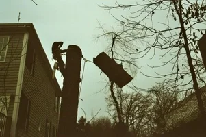

I believe I was wrong. One thing to keep in mind while slamming heavy wood close to the ground like in the attachment is that the force comes into the sling very quickly. On such peices I have seen some melting on the sling at the hitch. For this reason and the fact of unknown loads I would rather push the limits of a poly sling and just simply replace it rather than use an exotic fiber and perhaps be pushing the limits.
