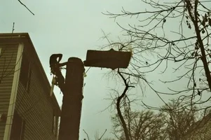

The dam muffler! I smoked my climbing line the other day. Turn the saw the other way. I do agree with Norm. Double braid for dumping wood for the same reasons.
