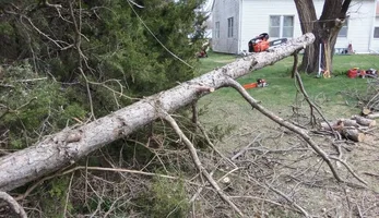

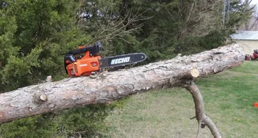

Gave the little Echo CS-271T a workout today... two dead pines blew down on an acreage I already contracted to do tree work for last fall. All of the pine trees died from blight, most of the elms are dead or dying of DED, lots of ash with broken out tops. Real mess. Anyway I did the two dead pines (one 14" DBH the other 15" DBH) today to get that mess out of the way. All limbing done with the little echo, and all of the spar until I hit 9" wood, then I switched to the MS-261C-MQ but that amounted to maybe a dozen cuts. Also took out a dozen or more small volunteer mulberry, hackberry and ailanthus trees growing in the treeline. Cut it all into small brush for the chipper, kindling and campfire/firepit wood. The little saw went through four tanks of gas and refueling/bar oil was just about the only time it wasn't running.
Never gave one bit of trouble and the property owner couldn't believe that little saw could rip through 8" wood so fast. It just got stronger as the day progressed. Green saplings and dead, dry pine all day. Very happy with the little saw. A few pics of the first tree, before I forgot about taking pics...
FriendNE-01.webp FriendNE-02.webp FriendNE-04.webp FriendNE-05.webp FriendNE-06.webp
