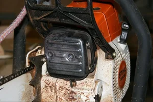

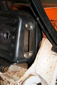

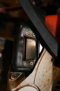

Here is a couple pic’s of the muffler mod I made on my 361. I drilled three 5/16 holes, used the screen out of my 200T muffler, made a stainless deflector and riveted it and the screen over the holes. I made a big difference in the saw, noticeably more power. It also sounds better. Hope this helps.

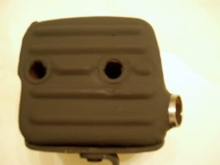

Here is a 460 mod that I build. I also have done the 361(as pictured), and I have a ton of stainless steel pipe for them. You are able to get 20% more power just from a muffler mod. The dealers will not do them, and if you need warranty service they may refuse service.
