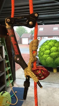

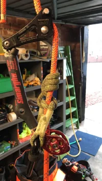

Simarghu make a single leg 7.5 in tether with a built in tending loop. I’ve always see a short hitch, your hitch should never bind if you use the right cord with the right hitch. The tether I used was an isc foot long and it was too long for the hitch I use. If a short hitch bonds up for you, use a different cord or try another hitch or try a long hitch. I like either a michoacan, catalan or a martin hitch.
Set up with 8mm courant cord, the sewn eye makes the hitch a bit longer. Second image tied with a Samson ice tail 5 wrap michoacan they work fine. I never liked the long tethers so it’s nice to hav a nice short system with minimal sit back which is nice when returning from a branch walk
The second image with ice tail looks like like the shwabisch hitch...the first one is the mihoacan

Well he claims there different...no way to be for sure on the second bc I can't see the front...but it could be either or.
I don’t see where he says they are two different hitches. More careful reading of his post has him naming the Michoacan and Martin hitches as maybe different. I’m now wondering which hitches he’s referring to.
Ya I assumed that - when he singled out the 2nd image.
I had heard others say the Martin and mihoacan are the same.
Don't know of the catalan but now that I'm looking at them more they both do look more like the mihoacan
All right I see what's going on here. The 2nd pic is the the mihoacan spun around so the back is facing the tether as opposed to the 1st pic where it faces the other way. (The more common way it's used)
Yes, the second one looks like a michoacan, I almost always use it facing that direction.
