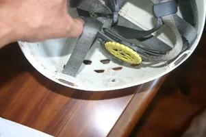

Jamin, the foam would crush and absorb the blow so you wouldn't experience anymore jarring or neck injury than with a suspension type. The downside as I understand it is the helmet would need to be replaced as the foam would no longer conform to safety standards.
North makes a hardhat that is Class II using suspension with a foam ring for side impact.
What about the eye shield fogging up? Any problems there?
the injury. I think the helmet did its job absorbing the impact. I dont know how foam would have worked. The cut was from the helmet.
