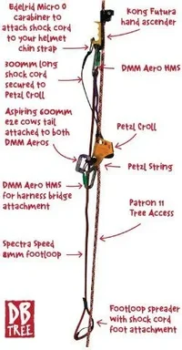

Just use a handascender connected with a sling to your saddle, under there a petzl croll attached to the suspending shoulder harnas and your saddle. A loop for the left foot connected to the hand ascender and a pantin on your right foot.
Take small steps and hold yourself against the rope. That's the best way to walk up.
But be safe ! - get to understand the whole hardware and techniques involved in SRT before trying without proper knowledge off the whole thing. If your not sure - just don't climb with it and go to see a climber that's doing SRT for a longer time.
good luck - SRT rocks !!
I think attaching something to the chin strap on your helmet is a really, really bad idea.
It is !
But in my writing i'm not saying you should dot that. I'm mentioning a shoulder harnas (suspender) to attach the croll to.
The picture was to clear up the points off attachment to the saddle, because thats one off the most maken misstakes that climbers that are not sure about the setup don't attach the both ascenders to the saddle and just climb with only 1 backup.
There a lot off climbers using different methods and i'm allways looking for innovations and other techniques, but safety first.
climb safe !
Drew does it on this clip but it does seem a bit ....iffy?
