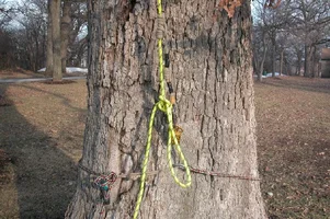

Here's mine. I use the same as Bowlegs for the same reasons.
Dave

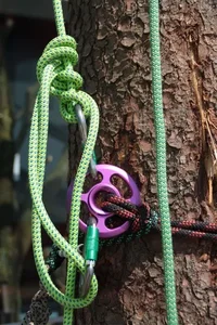

the way i anchor is with a sling around the base of the tree with a 3 paw plate on it in the middle hole goes a pirana with a 30m 10mm line attached and has the excess on the floor, i then have a op 8mm prussic to back that up on the rigght hole and on the left i have a dmm revolver snap gate to fair lead. i can set this up then when i put the throw line in and install my line i connect the installed line and basal line together and there is my line the access line is 55m which allows for a lower from anywhere on the sr'd line, its tricky without a image but i thought id share its really small to carry around and works a treat.
hope this helps, sorry its a bit complicated without the photo.

No worries. I understood it. And I like the Revolver idea as a fair lead. Perfect!

This also works well. Munter autoblocked with a prusik.
Hard to see but I think the munter is under the slip not right. That looks simple.
