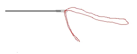

What else works really well, espeicailly with the tighter throwlines like the red and white Edlrid, is pulling one single thread out of a piece of zing-it, thread the two tale ends through a small normal needle (which gives you a loop)and stick it through the hart of the throwline. Attach your tapperd end of line in the loop of zing-it and pull in. The zing-it is that strong you can easily us pliers to hold the thread of zing-it.
works like a charm!!

Jelte, can you show a picture? I'm not quite understanding you here.

Nick, I think the attachment was what he was describing.

So you're using the strands of the line to pull it through it's own self?
Nicely done. I'll have to remember that one for when times get desperate!

Why not thread the tapered tail straight onto the needle?
