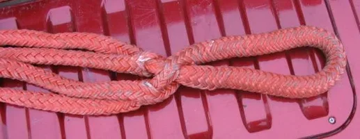

Tom, do you have this sling anymore? It looks really complex, but interesting. I’d like to see how it is made and how it looks in use. Does it require all legs to be connected to load properly, or can you use just one leg?This is the adjuster. The white sling has a large eye spliced in so that I can tie a Klemheist for adjustment. The small eye is where the biner would go that attaches to the sling that's choked around the limb like Lazarus is talking about.
I've used this configuration in 2,3 and 4 leg setups. It seems important to use opposite legs when I use less than 4 to keep the load on the eye splice balanced. Even if it were a little off center I don't think that the eye splice that is used would have a chance to invert.
That’s interesting. I may just have to play with the idea, but my brain has been going down a different rabbit hole of a sling idea For a while now.I don't
a couple of clues from memory.
Two pieces of large [orange[ Tenex are used. One buried into the other to form the big eye. Then some Brummel-esque crossovers to lock all four legs in place and share the load.
I used it as a 2, 3, 4 leg spider. The orange legs were about 30-42" which was usually enough, with the length of white adjusts, to do most of the time. Once in a while I'd add a webbing round loop to extend a leg but not often.
