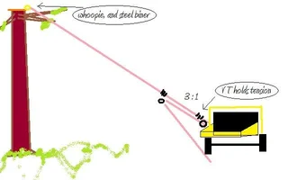

I've been trying to improve efficiency, reduce groundie fatigue, and lower ground impact by speedlining lightweight conifer limbs directly onto the low-tension speedline.
I'd like to be able to anchor the bottom of the rope at ground level and adjust the slack from the tree. This will free up one guy who was tensioning/ slacking while the other detached/ moved brush. I'd rather them both be able to do whatever is needed on the ground and I'll just sending limbs down as I'm ready.
How would you choker onto the tree and attach the rope?
I was thinking of something like a timber hitch with a steel 'biner, attaching to the slideline with a munter hitch/ mule knot or a figure-8.
It would not be a great bend radius or super fast to bump up at each whorl. I would probably have to attach above each whole, so that the biner and knot/ figure 8 would be out of the way of the sling and biner.
