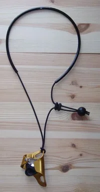

Here's a neck strap idea. on mine I have the elastic cord going through a piece of 1" tubular webbing. The cords go through a tiny plate that was the adjusting buckle on a camera neck strap. then, a spring loaded toggle on each end. Just a variation on the setup in this pic.
