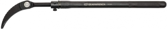

It is very tight space in there. I have an SK750. I tried to tighten my belt but didn't have the right tool. My mechanic friend came and helped me out and used a ratcheting pry bar made by Gearwrench. 1611494339699.png You have to loosen and pry on the alternator. Be careful of an engine sensor that's very close. He said it's tricky to put on a new belt but he can do it if he uses a mirror to see what's happening back there.
It is very tight space in there. I have an SK750. I tried to tighten my belt but didn't have the right tool. My mechanic friend came and helped me out and used a ratcheting pry bar made by Gearwrench. View attachment 72979 You have to loosen and pry on the alternator. Be careful of an engine sensor that's very close. He said it's tricky to put on a new belt but he can do it if he uses a mirror to see what's happening back there.

I'll take a mirror and slim bar of some sort. I have a couple crowbars too.
I had a crowbar that worked great to keep pressure on the alternator. The battery was also kaput, but we at least we're able to jump it and get it back to town, replace battery, and running like a hog again
