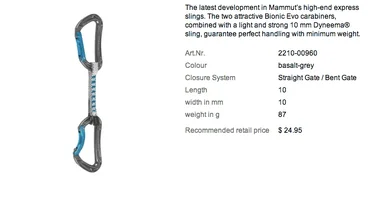

Just wondering ... could you use an actual strap (Dynema dogbone) from a quickdraw?
Not Dyneema!
Re: I don\'t like the Rope Wrench
Not Dyneema!
oops
EDIT: I have found the slings in various lengths (11-25cm) can be bought separately for about $5 ea. in nylon, dyneema, polyamide. Just google "quickdraw sling"
Not Dyneema!
For this application why not? That's not a life support connection to the RW. Even so dynema in webbing for a static connection (short tether you're not gong to be falling on) is excellent.
