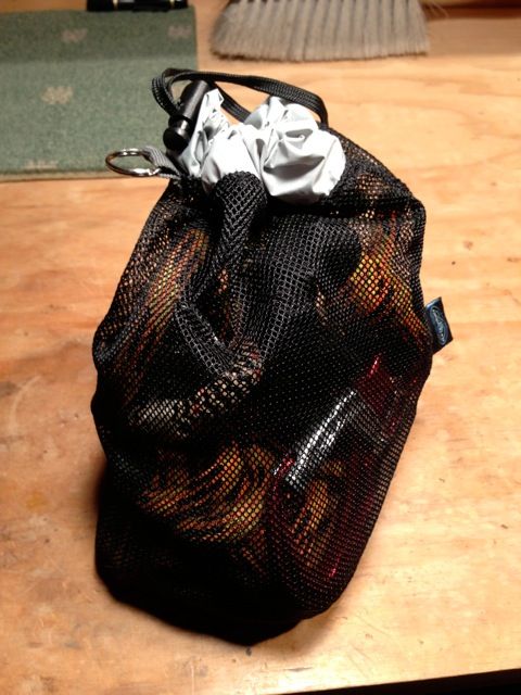

Mr Bill, I used to daisy chain, too, but for me it's faster to stuff it into this bag from Sea to Summit, then it's out of the way. I did have to stitch on a little ring, tho. There are several sizes ( mine has a 20' lanyard in it).
Great idea, just ordered the small one 6.5L. Sewing the ring on looks like it will be perfect, my ankle thanks you.

Not sure what kind of bag this is but it cost me $3 from the charity store.
It works well because its independent from the saddle....so you can shift it around your back if its in the way.

just curious what size bag it is that fits youre 20' of rope?
I think it was large, has a gray band on top. Also got the orange banded one, which is smaller. You'll find a use for that one, too.

And now to stay on thread, how big of a bag do I need to put all this in? After watching this video I ordered some more :)
Looks like the bum bag for my dirt bike tool kit, good idea!
Its branded 'mountain equipment' so I assumed maybe it was for packing a rain jacket or something. I does work very well because of the way it hugs you, is independent and above the saddle. Ive tried bags that hang from the saddle and they're annoying for several reasons.
