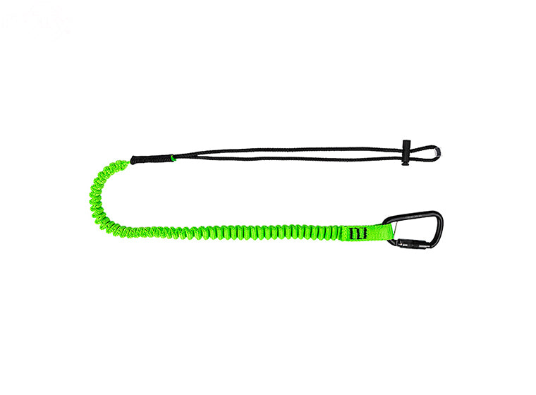

I use light weight lanyards like this:
If the saw gets stuck in a log, this will not stop it. Which is fine. If I'm cutting, the drop zone is clear anyways.
