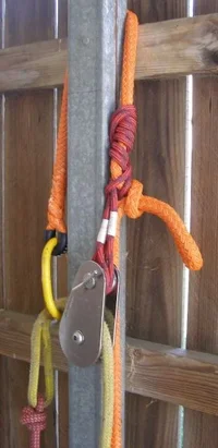

I know there has been a post about this before on the rigging FS but was wondering what is the maximum working load that guys who have tried this got out as far as the rings and has it been set up so it can be removed from the ground. I was thinking about this that if you had a ring to ring FS type rigging device that was removable from the ground it would be much easier than using pulleys. If you're taking off bigger pieces at the lower portion of the tree and have to climb all the way up to the top for your final tie in and set a rigging pulley or block, and then have to go back up to get the block why not use some kind of ring to ring FS. I was thinking you could use a double braid with two of the rigging rings and then have a smaller ring off that for the retrieval system. That way you're not having to chase down your pulley or block after you get done removing the lower larger pieces. Any thoughts or dispute would be great.

I've got a steel ring/ring FC that I use for rigging. All of the loads are well within specs for the FC.
Take the concept and build one with stronger pieces. You can get strong rings or shackles from industrial rigging shops. They have ready made webbing slings too. Seizing the eyes of the webbing slings to keep everything fair is easy enough too.
Here's a setup that Nick sliced up for me.

Tom,
Now is that retrievable from the ground without bombing it out? I mean the ring to ring or shackle I wouldn't mind but a pulley or block like that would drastically shorten the life.
Re: Rigging False Crotch
Yes..the red/Fly rope that is on the lower left, tied to the yellow double braid acts just like a throwline. In real life I might use a rope smaller than half inch, even a strong throwline would work.
Think of a climbing FC made from scaled-up materials.
If I didn't use a line to retrieve the setup I would be less worried about the life of the gear than I would be of the short life of who ever might be on the end of the red rope!
haven't burned through one yet. I dont do a terrible amount of rigging with it. If I'm doing rigging intensive projects, Ill use a block. For smaller things, and that one branch in a tree type deal, I use it all the time. its great because it reduces friction considerably, protects the tree, and the rope, and is simple and easily withdrawn. I use the same one for climbing and rigging and dont have to worry about it. Really handy lil tool. I suppose it will wear out one day.

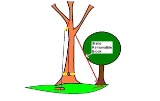

Well, this is what I call it. See illustration.
And, this is not to be mistaken for a Static Removable False Crotch. This can be found on page 100 in The Art & Science of Practical Rigging
--I'm too lazy to scan it at the moment.

I would be concerned about rope bend radius using just 2 rings or shackles.
Using a static removable block (assuming you mean a block slung through a crotch and anchored at ground?) you need to be careful about the doubled load you are putting on the gin.
Yeah i've seen that before and have chose not to use it for that reason. Which is worse putting double the load on the crotch or over straining some rings? Pick your poison i guess. To each there own.

Jamin that is the same set up I use . Tophopper you are also correct must watch the loading. THis is just another example of knowing how and when to use what tools?! nothing we do is perfect for everything
