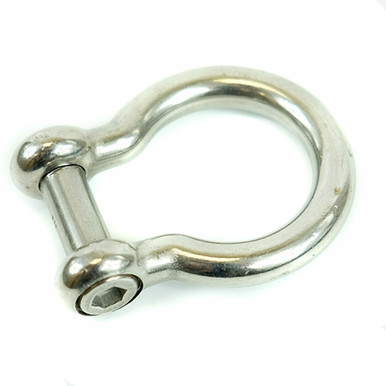

I used the TreeAustria for a time which comes with two shackles that can be opened just like most of this hardware. I ascended an oak 4 years ago and when I got to a working position in the tree, noticed one of the shackles had come loose and I was damn near close to losing my bridge and likely my existence on this planet. Ever since then I make sure to use loctite on the threads of hardware that connects the bridge to the saddle.
The open rings have a superior design to shackles- the bolt in the shackle takes direct force from the bridge or leg loop depending on how it’s oriented. The small opening on the open O will likely not take direct force because you can rotate it to a position where it doesn’t line up with a point of tension. Courants open rings have a puzzle piece design which similarly avoids putting direct tension on the connecting bolts, but it’s diameter is quite a bit more than the petzl and many eye terminations do not fit as well or at all.

Petzl Open O ring. https://m.petzl.com/US/en/Professional/Harnesses/RING-OPEN
Shackle, e.g, the one I specifically was using.

I see the risky innate design of the TreeAustria shackles, coming unscrewed. The design on the DMM shackles is clever, in that they have a small set screw, that prevents the main shackle bolt, from allowing the U section, to ever be open, unintentionally.

Many years ago. Many. I owned a couple sequoias. I used webbing bridges, as that is all they sold at the time. Those screws came out and went in. Blue loctite always. Or maybe red. The weaker one I know. But it is a thing one would inspect often. Never saw one loosen. I honestly would never go back to one bridge personally for work. I now own several EVOs because I love that damn thing. The two bridges just helps get proper work positioning in shitty spots without pulling at one bridge ring from countering angles. Those forces can be counterproductive. Just too much stressing in one spot. Two bridges allows for Forces to be dispersed properly throughout the harness and that transfers to a healthy and less stressed body.
