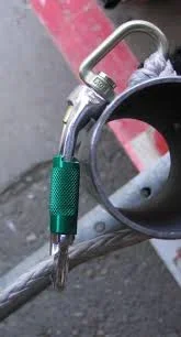

Here's a creepy pic of it sideloaded at 15kn.

Here's a creepy pic of it sideloaded at 15kn. I think this was an intentional testing of a Skylotec lanyard that uses them.
That's impressive, at 15k the gate is still intact/attached. 3372 pounds force, I find that reassuring. The message there is that the swivel extension is a applying more leverage than would occur in a non-swivel carabiner. Cinching a standard snap or a carabiner/swivel snap hybrid seems a bad idea.

Right, I would've expected it to break... or at least pop open.
I think there's a misconception that the forged aluminum alloy as used in carabiners is brittle or as fragile as a ceramic vase, it bends quite a bit before failure.
I'd like to see the same test on a say a DMM oval carabiner, probably going to go over 15kn before the gate pops (no leverage from the swivel extension), and then more before the aluminum completely lets go.
No carabiner manufacturer will likely do that or publicize. Understandable, it would undermine their general carabiner safety recommendations.
Would be even more interesting to do that test on say a well secured piece of hardwood same diameter/radius.
