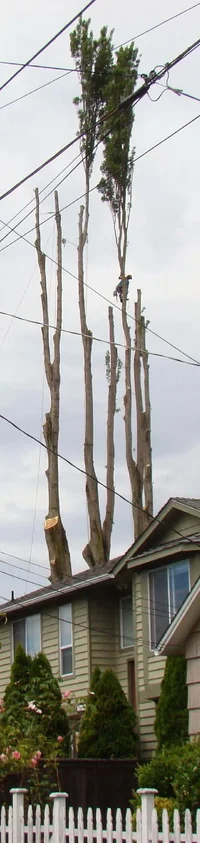

They're the biggest Lombardys I've ever seen by a long way, probably the tallest in the world by the looks of them.
We must be seeing it totally different Grove.
I dunno Reg, in this shot they look well over 100ft, maybe its just the camera angle, not that it matters a jot anyway what their height was, it was a job well done.
Lombardys have a habit of looking taller than they actually are because of the columnular shape.
We must be seeing it totally different Grove. In the video-clip the climber doesn't appear more than 50 ft up (unless the trees are in a dip) and he definately doesn't cut off 50 ft surely?, which makes the tree under 100.
Ummm, Reg, they were 145 plus or minus 5 feet.....the longest tops and leads that we roped out were 55 feet.....
I removed two larger ones last year...not in such a tough spot...maybe not as tall.
I think your perception deceived you on this one Reg.
Thats amazing Roger because I never would have put that figure on them.
