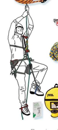

I probably will not have my climbing gear out anytime soon, so here is a pic that I borrowed off of Wesspur. The key components here are a foot ascender, knee ascender (SAKA, HAAS, homemade), SRT climbing device (rope wrench [pictured], Hitch hiker, akimbo, rope runner...) and a way of tending the device such as a chest harness or lanyard over the shoulder. Once you learn the motions that your legs must make, it is very efficient and faster than most other ascent systems.
