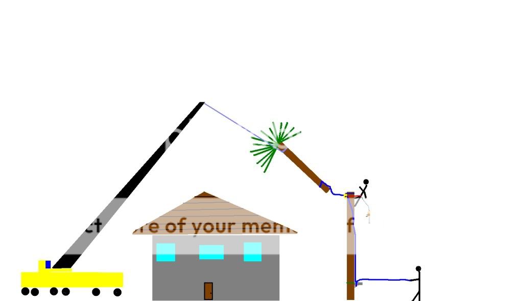

ok so i have this job comming up and we are bringing in a crane to asist in a palm tree removal. the crane will only be taking the top half off and then we have to fell the rest down a narrow walk way behind the house. blocking down is not an option becuase of the proximity between then house and then fence(6-7 feet). the crane will not be able to get the boom directly over the house so there obviously will be a large swing in the piece over the roof. i thought of an idea to remedy this. tie the crane sling to the top of the piece, then right above the cut tie a rigging line that runs through a block that then goes down to the porty where my groundy can slowly let the line out as the crane booms up and swings the piece over the roof. see the pic below and tell me if you have done this before or if you have other ideas??
Bigger crane. Side-loading a tree like that will make you sweat profusely and could lead to very bad things. Especially when you are feeling the pressure of paying for the crane, you may make some calls that are less-than-thought-out.
Now if it's a really small top, and the trunk will be really fat and solid, and if your groundperson can run a pow really well, maybe it's a good plan.
Let us know how it goes, and pictures!
Not a good idea. Go with a larger crane that can get directly over the palm. Have you had the crane company look at the job?
Yup, go with a bigger crane and bring in the operator before hand to discuss the job.
Definately not good. It will shock load the crane;side load the tree

The crane co. I work with won't side load any boom. They're not designed for that type of loading. Get the load line as 'plumb' as possible.
Have the crane co. come out and look at it. The crane co. I work with will check it out for 'no charge'.
If your buddy has a six axle crane like the one in your drawing I think you should go for it. Judging by the boom angle and the lack of jib you should have it no problem. You might want to use a parachute though, as your ground mans line will be no competition for the cranes pull on the spar, and when it releases you will want a controlled landing when you touch down in the next county.
These guys are right, cranes are not designed for sideloading(anytime the hook in not directly under the boom tip is sideloading).

Sounds like you should have the right size crane, or maybe proper the crane boom on the roof of the house, it will be easier than having the big crane come from the construction site and lift your too small crane out of the house. But seriously, rig it down using the right gear, or use the right crane.
Why can't you rig it down in the same space that you can fell it into? Maybe we can just come up with a group brainstorm solution to safely get it down and done.

i think what we are going to do is wait for the larger crane. that one can make it over the house no problem. i spoke to the home owner today qnd told her its going to cost more to do it now but there is a higher risk involved. i said if we wait a few weeks for the bigger crane it will be safer and cost the same. she is happy with this. but still i need to have a backup plan in case the crane gets another job somewhere.

You can attach the control line to the mini for ballast or the stump or another tree. Run it through a pulley on the piece being lifted, and run the line to the neighbors yard. You will get a 2:1 for controlling the piece, then the rope can be let go once you clear the roof. The rope will pull free from the pulley and drop into yard. I'd attach to the mini or stump midline to adjust your length. A light friction wrap on another tree for the release cut, or as you drew, a POW, can help.
