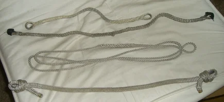

So I did a little mock test to filter out some types of cords and hitches that might work to grab the cable. Here's a pictures of the cords that were used.
#1= 1/4" Yale Vectrus vectran single braid. Spliced a few months ago with a scrap that was about to get tossed. I dipped the whole thing in maxi-jacket coating and used it for a bridge for my harness for a few weeks before abandoning it.
#2= 3/16 Yale Vectrus vectran single braid. I spliced this about 3 years ago when I lived in NJ. It served as a friction hitch for a few days on my climbing line. Then it eventually found a home as the adjuster on my 3/8ths diameter flip line.
#3= 1/4" NER polyester 3 strand loop. Spliced about 5 years ago when I lived in Chicago. Never really used it for much....occasional light rigging.
#4= 5/16ths Samson Stable Braid- given to me by JPS when we were working with Fred B. in Colorado. Served as a hitch cord on my climbing line for a few months of careful climbing (to see how long it would really last). I don't use it for much nowadays.
So basically, went out and found a telephone pole with a guy line anchoring it in. I found one just outside my house, and proceeded to check each cord with a variety of knots. The choices were:
1: Many wraps (like what many call a "french prusik")
2: 3 wrap prusik (aka English Prusik)
3: 4/1 Distel*
4: 4/1 Schwabisch* (how DO you spell that?)
5: VT/MT- no. of wraps dependant on what the cord length would allow
The guy wire i found was a very taut piece of 3/8 1x7 (i think) wire.
I tied each knot- some carefully, some intentionally sloppy. My goal was to filter out a few cords and a few hitches. Each cord was tied, then pulled on with body weight. If it held, I would "shock load" it by yanking sharply on it to see if I could make it slip.
In the meager test, only one valuable piece of information was found. Every single cord, tied with every single hitch, no matter if it was tied properly or poorly, held very firmly and did not slip in any case.
So does this mean that it will work? Absolutely not. Surely the cable I was using has more "texture" after being exposed to los angeles air for an unknown time. A brand new wire will be more slippery and may not hold ANY knot. Also, I don't know what this wire was made of- and that factor could make a difference as to its "holdability."
Was this test a waste of time? Not at all. We know it MIGHT work now. And though I don't have any cable available to me now, maybe someone else can try the test at home, with actual cable that would be used to cable a tree.
Just thought I'd share!
love
nick
*(the coated vectran could only fit 2/1, and the stable braid a 3/1)
