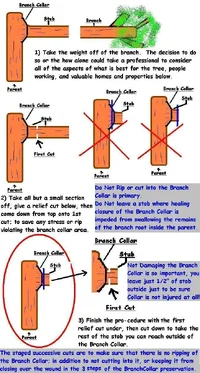

When trimming the growth pattern should be followed, least dfamage done, most poswitive processes maintained without flipping any high survival switches that may cause unnecessary over compensation and system distraction from strength to survival from the shocks of cutting techniques.
Cutting at 'tre-determined' joints and preseving their branch collar swells to close the wounding off cleanly is imperative.

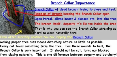

Thi biggest thing then is not wounding the parent; but leaving a stob can work the system harder than it needs to 2 ways. By taking more expen$ive closing material$ and time; also by possibly letting the decay from the stob travel to the parent, through the port that the stob itself maintains opened.
