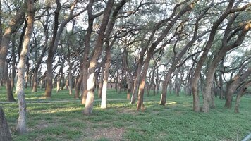

I like the idea of a wood working saw of some kind. They were some skinny leaner's that had never been pruned. Most of the target pruning was 12'-18'. I do get kind of stingy with the powered pole saws because the guys will start using it every time and settling for crappy cuts out of laziness.
