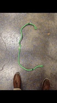

It's only like 5 feet because when I emailed treestuff they said it had to be under 6' eye2eye in order to break it on their machine. I still have over 100' of that PI left which I plan to put an eye on using the same formula I did for the other two (assuming everything goes well at treestuff) I attached a picture that shows the length
Cool, so you may be able to get some additional slack in the cover by milking from the first splice towards the second. If the entire jacket is toight like a toiger then probably not.
You might not really see any appreciable difference from one splice to the other as far as breaking strength with slightly different bury lengths. I feel the bury length has a bit to do with the security of the splice when unloaded.
The most important component of a strong splice is even balance between cover and core. This means all fibers will distribute the load rather than more core, resulting from a baggy cover in the eye, or too much cover slack remaining in the body of the rope, for instance.
You'll more than likely be able to put 2 splices in the remaining 100' due to more slack being available in all that cover to fully bury the second eye.
Only the test will tell where it breaks...best of luck!

That is what worries me about the second splice I did. I can feel the "baggy cover" in the eye. By the time I noticed it I couldn't pull the splice apart no matter what I tried to try the bury again.
Yup. So, if you shock load that eye, you may be able to get a bit more balance, but PI is real tight. That baggy eye will more than likely be the one to fail.
I think one of the real tricks to really nail in 24s DB splices is the crossover. I like them to be super tight, with the crossover forming a seemingly perpendicular angle across the line. If you can achieve that, and not lose core tension over the cover taper, they run home the best. The other important trick is maintaining that core tension as it wants to rotate around your hand during the final bury.

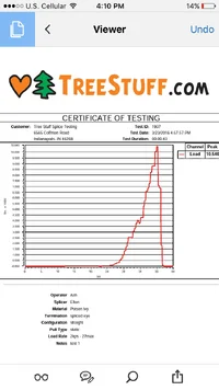

Got the results back today!!!
Very cool! It looks like it settled 3 fairly distinct times before breaking. First at 2,500, again at 4,000, and finally around 8,750 before going bust. Nice work there.

Yea it didn't come with any explanation so i was wondering what those dips in the graph meant? Is that normal?
Outstanding Chizman! You are definitely on the right path to relying on your abilities as a "Splicer", Great Results. Now, do it again and start climbing with confidence! Be Safe!
It's probably fairly normal for most splices. There's a lot of heat created when the fibers go into tension. When they suddenly slip, there's even more. With Class 1 synthetic fibers, that heat is what really breaks down their strength.
Without a photo, it would be difficult to tell what settled in relation to the different plateaus on the graph. I can only guess that the last plateau is where the point of failure occurred.

Thanks for the link. I really appreciate you going to the trouble. Also, that break test photo looks like things went absolutely perfectly; it looks like it almost broke dead center, with no hint of any failure of either of the spliced eyes. Nicely done!
