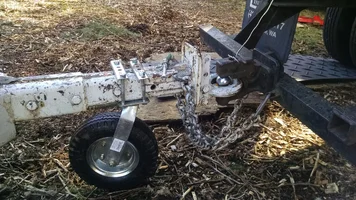

Another great thing about that machine is how light it is and with a caster wheel on the tongue jack two guys can push it about anywhere to chip brush in place rather than drag the brush.
I bought a 12" pneumatic swivel caster from TSC for $45 that will bolt onto the bottom of my tongue, easy on and easy off when I want to roll my chipper around.
I took Merle's idea and changed it a bit.

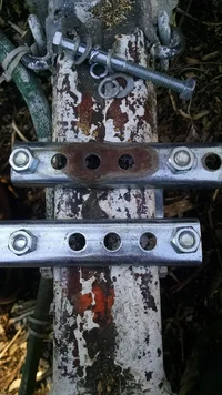

Tractor Supply company, 12", 450# rating.
Two bolts and nuts to attach, detach.IMG_20200227_132816823.webpIMG_20200227_133344981.webp
Thx for posting ur pictures. I’m lot more clear now what to do. I assume the it stays there pretty much permanently and u keep the factory jack where it is. I’ll try this. Hopefully the tire will never bottom out on my since my driveway have some crazy dips

Only when needed. Have yet to test it.
Might have to. Change the mounting to something stronger, but may not need to do so.
The casters holes are ever-so-close to the full width of the tongue. I round-filled the brackets on the top of the tongue to allow the bolts to fit, slightly out of parallel.
My chipper had very little tongue weight when the tongue is horizontal. As the tongue dips, I get a more tongue-weight. Tows great.

That looks good Sean. Far easier than welding a different mount bracket further down on the jack itself. I'll bet if you keep your eyes open you will see some nuts with leverage for quick/easy on off at some point.
As the bolts don't protrude, I could have some small re-bar, or similar, welded onto the nuts and bolts heads as handles, saving need for the tools.
