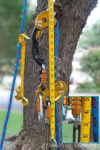

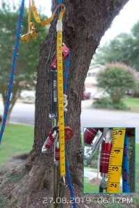

...Purchased the ZigZag Pro/2019.. then the Chicane.. set up to measure lengths, all were fully engaged using an old 50lb Toledo Scale cal weight, set ups & results were as follows:
Petzl - ZigZag Pro/2019 (mod# D022AA00)
Petzl - Chicane v1? (mod# D022CA00)
Petzl - OK Carabiner (2ea)
Yale - BlueMoon 11.7mm Rope
50lb Weight
System Length approx 17.0''
ISC - RopeWrench ZK-2
Tuefelberger - HRC 8mm sewn i2i x 26'' Distel-Hitch
Camp - Compact Oval 3-Lock Carabiner (mod# 0123)
DMM - Hitch Pulley (PUL100)
RopeLogic - Dbl Leg FIX Tether (listed as 10.5'', actual approx 10.250'')
50lb Weight
System Length approx 18''
..same rope wrench set up using the @Height Sgl leg Tether (listed as 11'')
System Length approx 18.875''

Sweet write up and thanks for the pics with the lengths shown!
