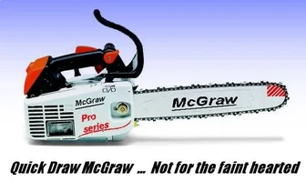

Haven't you got yourself one of these yet?
My point is if they wanted the 020 to be used with one hand they would have put the chain brake beside the top handle and not in front of the side handle.
one hand is simply less control... except for MB that is... /forum/images/graemlins/grin.gif to butch for me.
/forum/images/graemlins/grin.gif Nice one. i'll get one of those! Could you not have PSed the side handle off..... /forum/images/graemlins/grin.gif icing on the cake!
