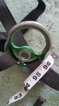

Gorman I have two old TM harnesses laying around maybe I can salvage a pair of lower Ds for you. No promises. Corrosion here is a bitch and I would never give someone life support that I would never use......

Gorman your call. They are beat. Still have life but not my call. Jimmy one inch webbing.View attachment 56556
Oh wow.. you weren't kidding about the corrosion! Is that cuz you live by the beach? Or possibly because all the dirt you encounter has some sort of acidity to it?
However... @Gorham, It's just a little bit of aluminum surface pitting.. I'd be confident on them.. good find mate..!

You will search no more these two TM lower Ds are your ticket. Show some pics in a thread when you are done the mod.....

Corrosion comes from lack of maintenance from sweat. All will be good. They just want some water sand and regular cleaning from sweat.
Ahh.. i gotchya.. That's allot of sweat mate! I guess you do, do more down there than sit back with your feet up living life like a Corona commercial! ;)
