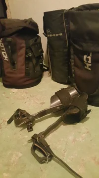

I’m planning on getting a new set of geckos but I’m not sure which ones I should get. What’s best option for weight, price, and longevity? Steel, aluminum or carbon fibre? Do the DMM shanks make a difference? And I climb a lot of softer trees (white pine,poplar,basswood) sometimes red oak and maple. Are the tree gaffs shorter like a hybrid or should I just get pole gaffs?

I wear a pair of carbon fiber Geckos, and have found them to be comfortable and incredibly lightweight. I haven’t had mine long, but one of our contract climbers has been using his for years, every day, and still loves them.
The tree spikes have never been in a tree on my DMM geckos. I got them and a pair of euros, and they are pretty short and bite really nicely.
Unless you're spiking nasty pulpy dead pine or some giant conifers, I would go short.
Even mature (36"+ dbh) pines don't have thick enough bark to make it an issue.

There are the carbon fiber geckos, the Dmm geckos, and the original geckos. They are all very similar.
The notch geckos are completely different, different pads, shanks, and shin piece.
I’m not saying they’re good or bad, just my personal opinion of notch is pretty low.
