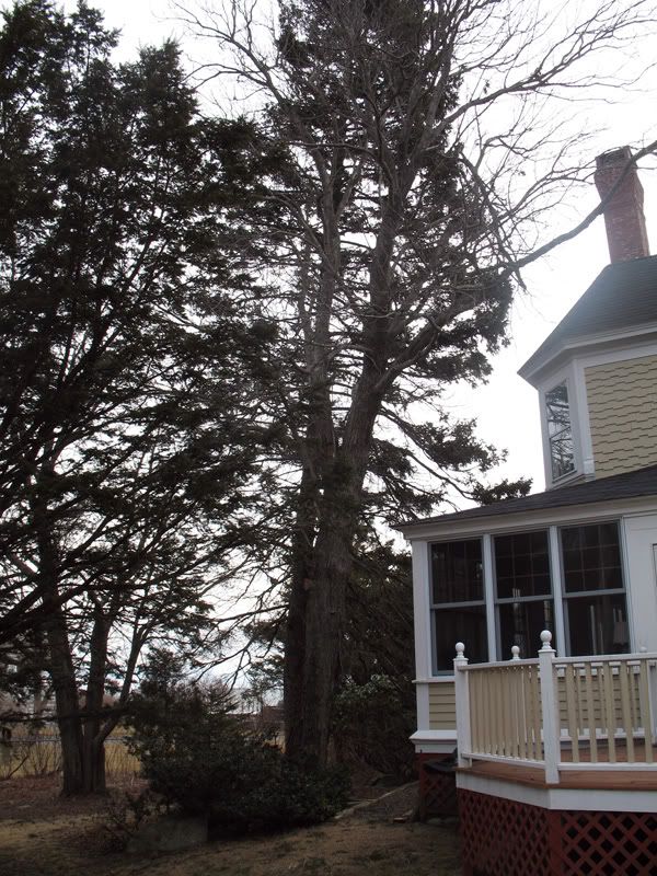

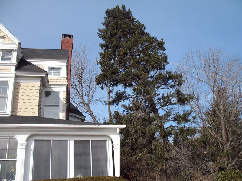

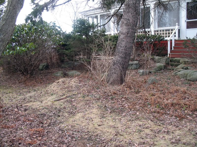

These trees are spitting distance from the Atlantic, it was 50 feet on the other side of the street from the house, so kept things pretty squatty and stunted. Spruce had partially uprooted and came to rest on the Red maple, both were decided to come down as the maple was over the house to begin with.
Lifted root plate. Roots remained intact, no breakage, woo hoo!

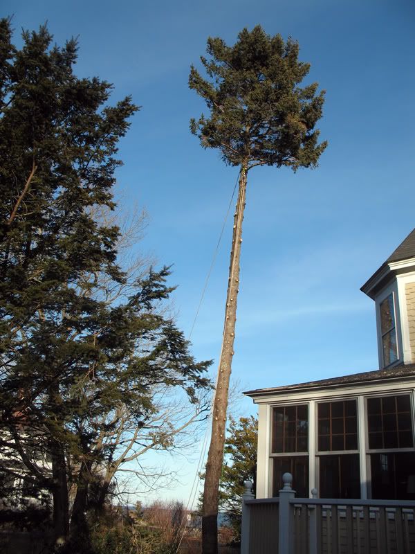

Went up the spruce in the morning and backed it up with some 5/8" stable braid as I wanted to start with removing the maple so I didnt have to fight every limb of the spruce on the way to the ground getting hung up in the maple. Didnt budge all day, but better safe than sorry.
Maple gone, spruce made into a sweet toilet brush.

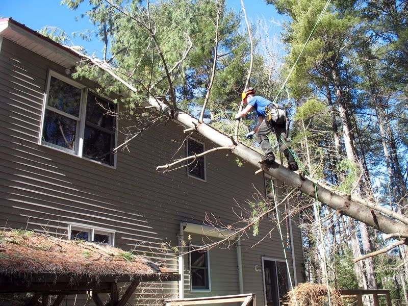

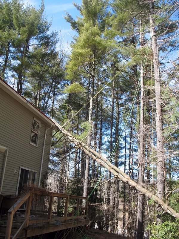

Saturday was a fun one. 2 uprooted pines layed onto the house.
Roof was metal (and slick as hell with pine needles all over it!), and nothing directly over the house to provide support, so tossed my throwline over the house, ran a 1/2" line over the roof with a pulley set on the end and my climbing system set on that and secured to a tree on the far side of the house, and double crotched with that in conjunction with a tie in point another big pine in the back used as a rigging point for lifting the wood off the roof.

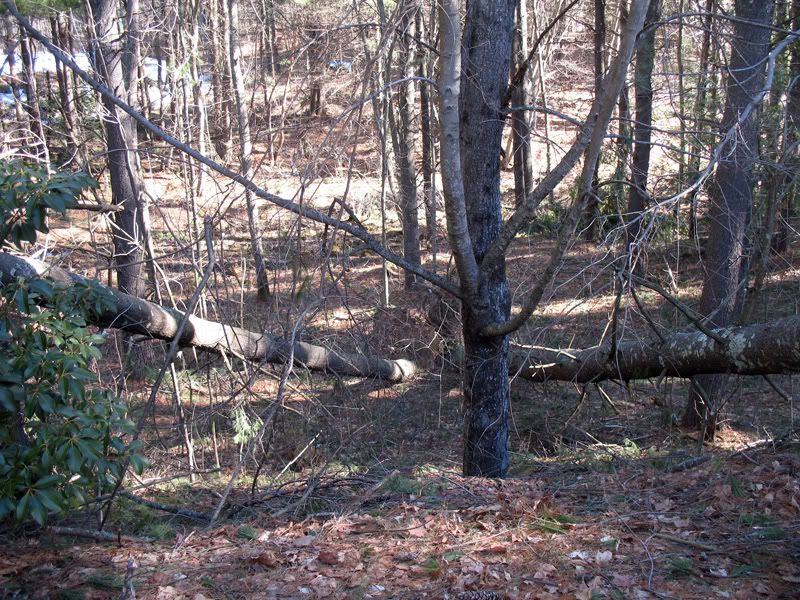

Everything went right to plan, cut everything off the roof and tossed it off, tied off the tips and had the line run up and into some of the bigger trees at the edge of the woodline, cut the trees off at the top of the hill to avoid having to lift the entire tree and rootball, and allow it to swing off the roof. A few cranks with a come-along and a pull line set, and they were lifted and swung off the house with ease! Love it when a plan works.

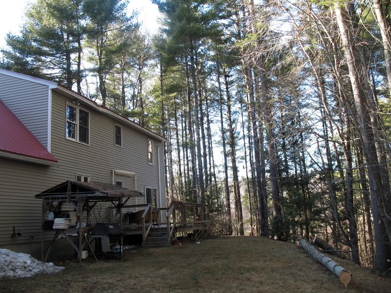

Ready for the roofers!
Sounds like client had post-storm heebie-jeebies. Maple barely hurt and could have been pruned and left very stable. o well can't win em all.
That's what you'd think, but the tree actually had a slight lean in the trunk and most canopy weight over the house, along with several large tearout wounds on the trunk. Come to fund out, notching it to drop the but, was already 25% hollow with probably another 20% completely decayed. Oh well.
That's what you'd think, but the tree actually had a slight lean in the trunk and most canopy weight over the house, along with several large tearout wounds on the trunk. ...
[/ QUOTE ]thanks for the details. the lean and canopy were visible from the pic and pruning would have addressed those, but tearout wounds are often fatal; they typically indicate owner neglect imo so too bad, their fault,their loss.
how does the loss of the spruce and the maple affect stability of the adjacent grove?
Any mitigation possible?
