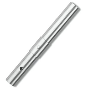

I had a spare male ferrule and broken yellow fiberglass pole section. The glass was just a little too tight a fit to slide over the tube on the Line setter so I slit the fiberglass length wise. That got it over the Line setter tube but now the fiberglass would not fit into the male ferrule. I had to make the glass smaller so I hit it with a belt sander while I spun it until it fit. Slid the ferrule on and drilled through all 3 layers and locked it on with a self taping screw. Solid as a rock.
I saw a tool like this a long time ago. I think I was in school. These would work great for us doing street tree pruning like others have said.
I cut a 4 inch long piece of 1 inch dia schedule 40 pvc pipe left over from a water line and put it in the vise and used a flap disk in the side grinder and sanded the outside lightly until it slid into the yellow Jameson poles. Then peiced everything together and drilled the hole with a 21/64 drill bit. I'm going to epoxt the pvc to the line setter shaft so I dont loose it. Everything fits perfect.

I finally got around to permanently mounting mine to a pole saw head adapter. There was a bit of play so I used some fiber fix tape to "shim" and affix the device to the adapter. View attachment 68320
This is a fiberglass tape with resin that you wet with water. I just slid the saw adapter over the tape while the resin was still tacky. Its solid as a rock now.
