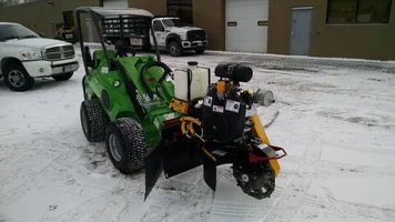

I had a 26 prior to the 38 and it was great until you got into 30" on up. Sometimes you have to do a giant one with gate access...the 38 is up to it, 26...get a motel room nearby. Both of these can be easily boomed into a yard with your crano.
First day we had the 26 back in 2011
I rented the 26 and was disappointed at only the power. The 38 must be the ticket! We spent all day grinding stumps. Did remind me why I never want to buy a stump grinder. Too many guys around here with just stump grinders doing it for fun... Anyways, This machine really shined when we had to navigate tricky back yards or travel distance to get to the stumps and when there were several stumps in a yard to do.
Nice set up but isn't the grinder attachment like $15,000.? And you have to tie up your mini when it might be needed. But a nice looking unit nonetheless. Norgaard did good on that one. Pretty sure it is diesel?
