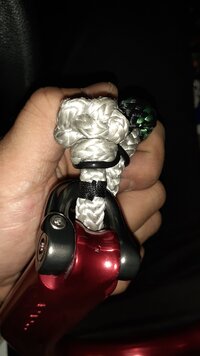

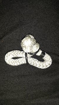

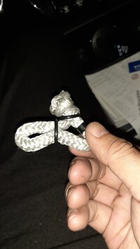

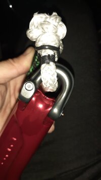

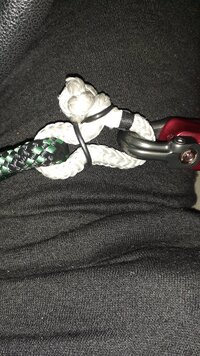

I usually put small diameter hole or I should rather say adequate size of black grommet O-ring "s" on a soft shackle to prevent that knob get wiggling out from the loop and also to make entire loop into one straight double line . To minimize soft shackle getting caught on the twigs . To make the soft shackle loop into double line you may use "ZIP Ties" instead of Rubber O rings . Heck.
Due to its characteristics of rubber grommets it doesnt make any of that annoying noises. Jingling metal sounds might be good for repelling bears it might be but real Pro says those bear bells wont do a thing but simply wasting time away to repel them . It would rather "attracts" and giving clues to those really hungry and "Real Deal MAD as hell bears that is really going to "HUNT" you down then murder you abd chew your inners out from your belly with absolutely no hesitations . What do you expect from a Real MAD bears ? Are you gonna say it's just a joke ? Well, good luck on that.
This whole idea of using soft shackle is very whacky idea but it seems working beautifully so far.
But again, hook is not a PPE device and so as using this whacky idea of soft shackle with O rings or Zip ties to cinch it down together also. One does need careful observations and check on each components especially no Elasticities , dried out & cracked "BLACK" O-rings , and each connections carefully before you climb is absolutely essential to prevent any unexpected incident which might happens one day on my body & my life . LoL16706531102943960627493927743755.jpg

I usually put small diameter hole or I should rather say adequate size of black grommet O ring "s" on a soft shackle to prevent that knob get wiggling out from the loop and also to make entire loop into one straight double line . To minimize soft shackle getting caught on the twigs . To make the soft shackle loop into double line you may use ZIP Ties instead of Rubber O rings . Heck.
Due to its characteristics of rubber grommets it doesnt make any of that annoying noises. Jingling metal sounds might be good for repelling bears it might be but real Pro says those bear bells wont do a thing but simply wasting time away to repel . It would rather attracts those really hungry and Real Deal MAD bears that is really going to HUNT you then murder you with absolutely no hesitations .
But again, hook is not a PPE device and so as using this whacky idea of soft shackle with O rings or Zip ties to cinch it together also. One does need careful observations and check on each components especially no Elasticity, dried out & cracked BLACK O-rings , and each connections carefully to prevent any unexpected incident which might happens one day on my body & my life . LoL
