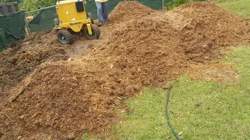

3/4 wraps I cannot live without any more. There are on every saw I own larger than my 261, standing at the stump it's so nice and comfortable when felling where you only have access to one side of the tree. Except for driving the mini over a stump, I never need to cut a stump lower than 4-6" from the ground, let the grinders the rest of it
