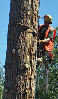

Cris Fraser got this shot of the lightning scar from the bucket truck with his 35mm camera.
What looks like an extra flipline is the rope used to attach the saw to the tree while cutting.

Ox, how are you attaching the saw to the tree? Is it just a cinched rope with enough tail to clip to the saw, or how?
