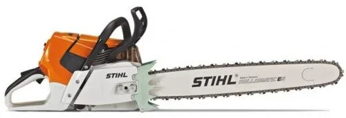

From what I have heard from my friends in Germany, the 661 is all but finished in design and testing there. They have been appearing at trade shows in eastern and central Europe and word is that they will be out in Germany in October. Likely they will follow in the winter or spring of 2014 in North America and Oz.
New 661 features: SS muffler, spring loaded AV frame (similar to the 441), centrifugal air flow for cleaner air filters (similar to the new smaller saws), air injected Strato Charged porting (similar to the new smaller saws) and they will have the M-tronic autotune computer controlled carb and ignition. It is still unknown if they will have a quad port like the 461 which has better cold starting. It will not be fuel injected, as some had predicted (like the new Stihl cutoff saw has).
Basically it will be a larger version if the 441 M model that is available now. The 441 is only available here in the M model now in the US and the non-M models have been dropped. The 661 will be a lot smoother, have a tad more power than the 660 and a wider power band. Cost is estimated to be about $1300 here in the US, and of course because of tariffs and taxes, it will be way higher in the EU and Oz.
