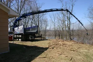

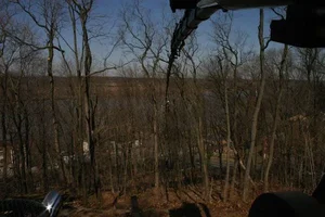

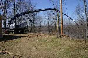

Here are pics from a job overa bank. I had all hydaulic an 2 manual extensions out.

Seems to me working with a knuckle boom (crane) like that would take some getting use to. That one pick looked like some better postioning of the slings would have made for a smoother pick but hea you cant get them all right. I am just jealus because we still have to rent our crane. Hopefully Not for long though. How much extension does that thing have? and who makes it? Very Nice job!!
Nice photos looking down the bank Mark! As for the video none of those picks hurt your K'boom. The log pick (at the end) only looked so bad because the boom wasn't pretensioned enough! But look at the position you were in! Under the lowest wires on the pole with the main boom below horizontal AND the jib OVERCENTER 20%!!! You knew if you over-tensioned the log pick, it would've popped up & taken out the wires!!! Sure if you used a 100 ton crane at that radius it wouldn't have bounced like that but a straight boom crane couldn't have made that log pick from under the wires!!! (shorter slings would've helped on the log pick IMO)
[quote (shorter slings would've helped on the log pick IMO)
Exactly, I was wishing I had a couple at the time.
The shorter slings would have helped because by the time I tensioned them I was hitting the bottom of the wire. If I had shorter slings I could have taken up enough tension so the piece would not have dropped. When the boom is horizontal you need to pretension it so the flex has been taken out of the boom.
